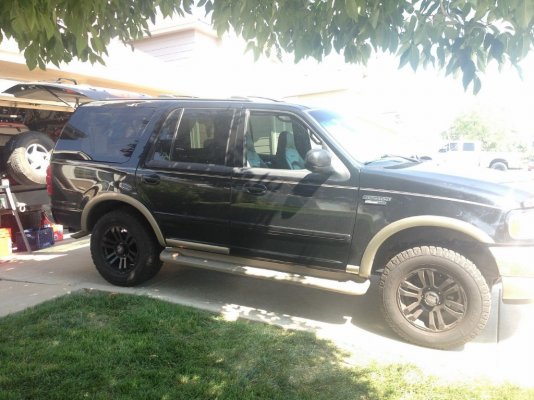

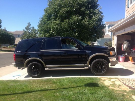

Living up to its namesake a little while handling the duties of family camping mobile. Had to take an easy trail to get to the campsite. Crossed a stream 5 times, some suspension twisting berms, steep climbs. Packed in 4 people, 2 dogs and 2 nights worth of stuff.

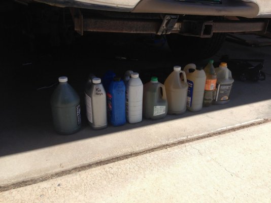

I haven't done the Hayden yet but I finished up the fluid change.
I didn't measure what came out all that well but I estimate it to be about 12 qts (I filled several containers that had a little fluid in it already). I was surprised at how easy the pan came off- once all the bolts were out gravity dropped it. I was expecting to have to pry or pop it loose somehow.
I didn't check the fluid level before I drained it. After I added the estimated 12 qts I drained out, I checked the fluid and didn't see any so I added more. I figured I had at least as much as I had before so I drove to dinner and back to get the transmission nice and warmed up. Still didn't see any fluid so I added another qt and got it on the dipstick. Added 1/2 qt and got it into the low end of the "hot" part of the dipstick. I figured since the trans temp was only around 142 (ScanGauge) it was probably pretty good.
So estimated 12 qts drained. Refilled close to 15 qts. Something's not right.
