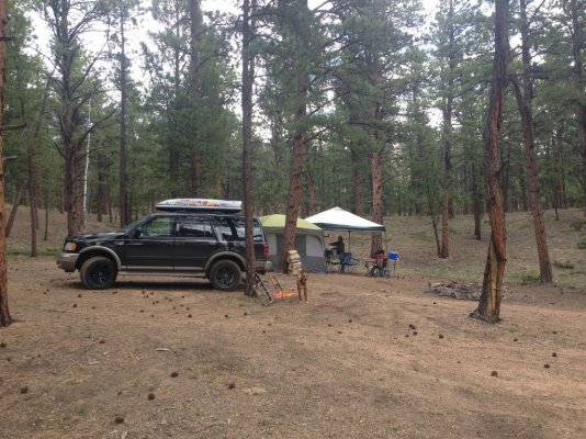

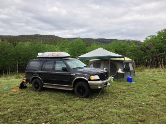

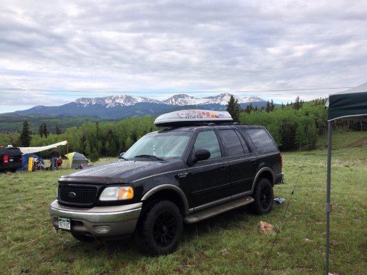

Living up to its namesake a little while handling the duties of family camping mobile. Had to take an easy trail to get to the campsite. Crossed a stream 5 times, some suspension twisting berms, steep climbs. Packed in 4 people, 2 dogs and 2 nights worth of stuff.

Last time I was in co, I got shut down on the mountains on i76 eastbound west of denver. Nice place otherwise!
Also. That wax looks fantastic. I need to get the time to wax mine but I stay on the road too much. Maybe I can just wash my semi and feel better

Looking good. That's one thing I need to do one of these days soon is take the expy camping.
