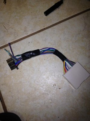

hey guys so my friend totaled his car and i decided to scrap it for the radio and other stuff:party36::party36:
so i got this HU and i went and got a harness and dash kit from my local shop ive wired the harness. havent got into my truck and started opening things up yet
when i bought my harness another one came with it he said its for the sub
my prob is idk where to wire these 4 wires to
and theres also 4 wires on the HU harness that idk where to route i tried looking for a diagram online but i couldnt find one

cant really tell from your pics where did you put the two black wires for the RCA plug for the sub i can see you spliced the two blue into the harness
do i splice them into the harness i got in pic 3?

I just installed a new HU on my second gen. The harness in the 2nd pic is for the sub. The rca's go into the sub out on the hu and the blue wires go to the remote turn on from the HU. As for the 4 wires from the HU, you would have to read the wiring diagram for it. I think the green wire is for the parking brake so it will play a video, at least that is what is was for on mine and wiring colors have a standard color patern in the aftermarket world. For the backup camera, run the power wire for the camera to the backup light(either one) so the camera comes on when you put it in reverse.

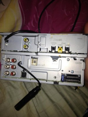

hey guys so i got the rest of the stuff in nav antenna, R camera and steering wheel control module i figured out the sub wiring and most of the module wiring i just had a couple more ?s
on the end of this module there is a jack (PIC 1) and a blue wire with a yellow stripe in the instructions it says run wire to harness on HU i did that but it dosent say anything about the jack or where its supposed to go i have pics below to show what im talking about and a pic of the back of my HU (PIC 2)

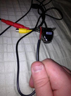

for the reverse camera theres a video wire that is very long im guessing it goes from the HU to the camera theres another wire which is red and at the end has a black and red wire (PIC 3) im guessing i wire this to my reverse light which is no problem my ? is will that enable the camera to automatically turn on when i pop in R or is there something else i have to do ?

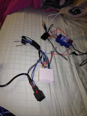

im guessing its a completed harness besides those now 3 wires from the HU (PIC 4)

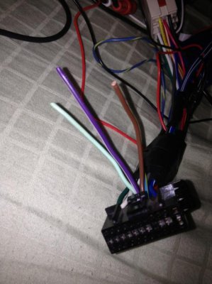

brown
Purple with white stripe
and the light green <(PIC 5)
brown

For the swi, the black line should go to the wired remote input on the hu. I'm not positive on the backup camera as I don't have mine yet but several different instructions have said to wire the camera power to the back up light. When you put it in reverse it should also turn on the cam. I plan on running my wires above the headliner.

Backup camera i wired to my reverse light and to the HU and it displays on my HU only prob is it dosent come on when I go in R I have to hold my Nav button to get it to show anybody know a way to get it to come up as soon as I'm in R ?

If it displays when you change it manually, then there is probably a setting you need to change in the radio.
