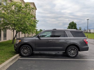

Wel looks like he actually uses his for off-roading not cruising the soccer fields ed
You can accomplish the exact same overall diameter and aggressive tires with 20” and 22” wheels. Looks way better in my opinion. To each his own.

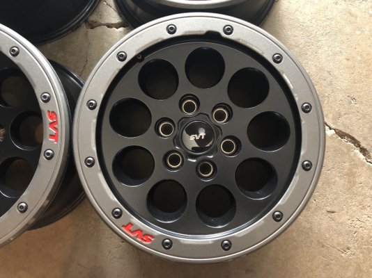

Agree this isn't going to be everyone's cup of tea. Just happens to be mine. :)
You can get a similar look with 20-22" wheels, but you compromise some ability to air down for improved off road traction. The larger sidewalls also offer greater protection of the wheels. Both of these are important to me.
you cant beat the price though you could get a set like his raptors for 900 buck with brand new tires on them and sometimes the tps. 20 inch rims are ok but if you are trying to take it offroad the raptors are the best option in my opinion..but I lean toward a stockish look as opposed to ROCKSTAR type rims... that's just me
Exactly! It would have cost me more than double what I have into this setup to put new wheels/tires on. These also came with TPS sensors installed.
Like you, I also prefer the OEM look of these wheels. There aren't many aftermarket wheels that appeal to me. Especially when looking for +30 to +44 offset.

can you tell me more about offset I saw a guy who has 20 inch fuels with only 1mm offset.. his wheels look good too and I was going to do that until I saw this post... then I see that about the stock offset and was wondering ….thnkx for the post....
MATT0404
MATT0404
Aug 7, 2018
86
125
NW PA
The lower the offset, the more the wheel will stick out towards, or from, the fender. Offset is the measurement of the hub in relation to the centerline of the wheel's width. So at +1 the hub is just 1mm to the right of centerline. This will give the wheel a more concave appearance or a large lip and the wheel will stick out of the fender more. Offset can also be negative, meaning the hub is actually to the left of centerline.
Our stock wheels are +44 so the hub is 44mm to the right of centerline. Meaning less concave appearance and tucked into the fender quite a bit more (than +1). I wanted to stay as close as possible to stock offset to reduce likelihood of the tire contacting the fender.

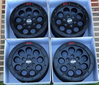

Yes, forgot to mention that in the OP. As expected, the rear center caps won't clear the axel shafts. I'm not sure which approach I'll take yet. Leaning towards modifying the center caps.
Any plans to accommodate a similarly sized spare tire? I assume the stock spare could be used temporarily on the front when in 2WD to avoid any driveline issues with different sized tires.
I'm casually keeping an eye out for a similarly sized spare. I haven't actually checked to see if a 34" spare will fit in the factory location. Stock spare will do in a pinch for now.

I scored a set locally....my build is finally setting sail....
And you officially suck!!!! Can’t wait to see them installed!

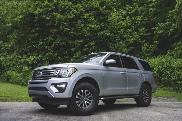

Here she is with the ReadyLIFT 3/2 installed. Tires still rub, but just the fender liners at full lock. Still need to test articulation to make sure they clear the fenders at full stuff. If it's just the fender liners, I'm not too worried about the rubbing.
47105789664_475f3aa89a_b.jpgLifted 2018 Ford Expedition by Matt Krepp, on Flickr
Yeah looks sick bro! Good luck with the articulation stuff. I know at full drop your UCAs are going to be sitting on the springs. I can tell you that much. Not sure about fully compressed
look nice bro... can you show off more pics like.. I like this offset and with the lift it looks amazing and still stock... love it bro.. I still cant decide if I want to go get the svt rims. I have the guy holding them for me till Friday... I think I will after seeing this....
Thanks! And, yes, I noticed the UCAs are very close to the springs at full droop. This is not the ideal lift for off road, but it'll get me by for now until something better (hopefully) comes along. Until then, I have my Land Cruiser for the gnarlier stuff.

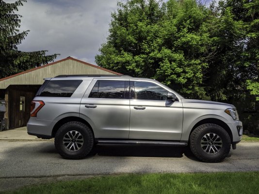

Here's one I took right after installing the lift:
47885563911_e933380abe_b.jpgexpy by Matt Krepp, on Flickr

Is it just me, or are the rear tires not centered in their wheel wells?
They appear to be a bit forward of center. I can't say I recall specifically, but I'd venture to guess the rear wheels aren't centered in the wheel wells in stock form, either. The effect is a bit more exaggerated in my case.
The spacers change the angle of suspension and will pull the wheels forward. Happened on mine too, nothing you can do about it except go back to stock
