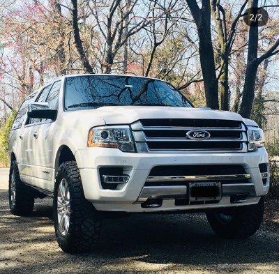

Looks real good. I wonder how well a 295/70/17 would fit & look on those wheels and the amt of rub....assuming a 3/2 lift. Probably none?

Yes headlights need to come down. Idk about the 4th gens but my 2016 has a screw recessed in a hole right behind the headlight housing you can access by opening the hood to move bulb up and down. I would recommend adjusting ours accordingly.
As for offsets. I’m running the 3/2 with 35/11.50/20s on stock +44 wheels with 1.25” bora spacers. This would equate to approx. a +12 offset (44mm - 31.75mm (spacer width in mm) =12.25mm) if I went the route of replacing the wheels. Mine are in excellent shape so saw no reason to blow another $1400 on wheels yet.

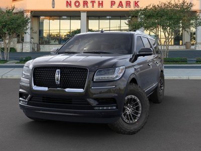

The 19+ Raptor wheels are growing on me... I hope we have as much tire clearance as you guys. That is great news factory Raptor tires fit in the event you can find a set already mounted.
Are you going to mount a set on your Navigator? Feel free to be the first to work all that out, then share all that knowledge with me.

Absolutely,
I'm going to start with the 1st gen wheels since I have them sitting in the garage. I'm leaning towards 33.8" Nitto Ridge Grapplers for tires...
Looking forward to hearing about this process. With that diameter you’re doing a lift I assume, correct?

Whatever I can get away with having CCD... The big question for us CCD trucks is can we reprogram the computer to not look for it, or can we trick it to thinking the shocks are still there. Icon makes shock replicators for the Raptor, fingers crossed they work on our trucks too. If I can get around the CCD I'd like to get the icon setup. Adjustable height and stiffness with proper upper control arms is very intriguing. I ran a preproduction set of Icon 2.5 coilovers on my Raptor for about 60k miles and they were flawless. After that I ran King 3.0s but they were noisy (the bypass valves click) and are total overkill for what I'm going to use this truck for. Icon is a much better setup for DD duty...
