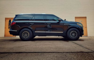

I found a guy who was selling his 2020 Beadlocks and didn't realize what he had. I could not be happier. Thank you Matt for the heads up on the zip ties. Had it done before the wheels arrived. I ground the axle down to the threads but still need a spacer to clear. How far are you guys going?

Those are chubby AF! Looks good.

I had to remove about an 1/8th from my plastic cap...on top of the .250 spacer. With a lift, your ride will be hot.

I'm undecided on the lift...
My wife is super short and honestly I like the tucked big tire look. It exaggerates them a bit and doesn't effect driving character... Maybe one day when I actually have a chance to get it off road and I realize how low it is... Plus it will be spending a fair amount of time towing so that will have to be taken into account.

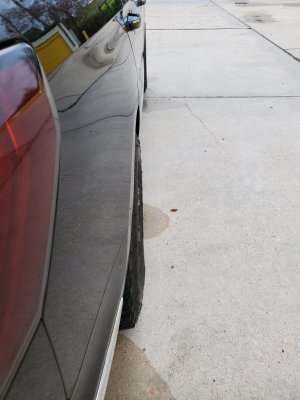

Rubbing is minimal and I think a couple more zip ties is all I need up front. I'm also thinking of only putting spacers in the back because of that, is that a bad idea? The back seem more pulled in than the front. Slightly... I guess ill order 4 and see how it looks before making the decision.

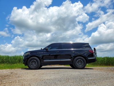

i did a write up on my swap. i cut between 1/4-3/8 off th eagle halfshaft and had plenty of room for the cap. no spacer. ps yours looks awesome. i couldn't find the newer beadlocks for under 2k. i like both and my wife prefers the other ones. i ended up getting eight so i can match a trailer when i get it built

Rear? Nah... They articulate up towards the rear and there is plenty of room. Honestly I'm more worried about droop in the rear. When I get the front completely set I'll rti it to find the weak points and let you know. Most of the contact points on the liners are soft ie nothing behind it so I'm confident I can make them go away completely. These raptor "35s" are cheating though... Your width and backspacing is what's killing you...

It is truly insane what people are paying for 17s... I bought a set of rough non Beadlocks thinking it was the best I could do but these weren't much more. Was it 1/4" total or 1/4" off the threaded part? Did you do anything special to protect the threads? I'll probably put spacers out back but keep the fronts tucked to help prevent rubbing...

i cut roughly 1/4-3/8 total each side using a sawzall with a 12-14tpi blade. i just went kinda slow cause at full speed it burned a blade up real quick. when i slowed the speed down it cut no problem. took maybe three minutes a side. sprayers the blade intermittently with wd40. then took a piece of cardboard and pushed it over the axle and sprayed the end with spray paint to prevent rust. worked like a charm. i think i posted photos of the process if you search raptor wheels it comes up. now we just need to raptor suspension swap and were all set. im working on collecting the parts slowly
