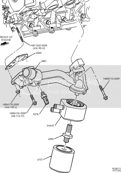

05 Expy Oil Filter Adapter

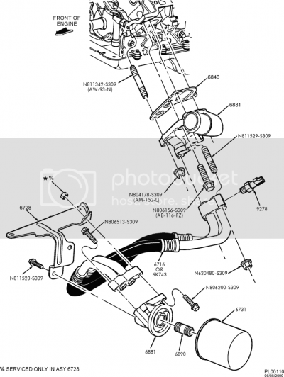

97 Expy Oil Filter Adapter w/ remote mount
I have been saying this will work for a while but nobody has wanted to try it! LOL! And i dont have the need to prove it works since i have it already!

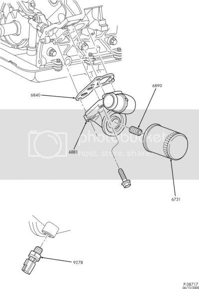

Great diagrams, rburch. Thanks. Now, I need to re-think my options. From these diagrams, it looks like that water pipe to the block, while being part of either adapter, doesn't contribute much, or at all, to any water to oil intercooling. So, was there ever this type of oil cooling to the engine, either '97 or '05? I have a flow concern with using the Saab cooler. It's metric IN/OUT fits a 5/16 equivalent barb, which would be between AN fittings of -4 and -6. Quite small compared to the Trans-Dapt 1/2 inch pipe thread of the remote oil filter adapter, which is AN -8. So, I'd like to find the ID of the pipes and hoses to the remote filter. I'll measure OD with a caliper tomorrow. I hope the standard hoses to the remote filter on the bottom diagram for the '97 is closer to the Saab oil cooler ends. Otherwise, I'd be concerned with the change of oil volume and flow between the oil filter bypass, the oil cooler and then back to the engine. Then, I may have to spring for an Earls AN -8, 16 row cooler, which is better matched to the bypass adapter. It would be easier to make up hoses for that. Can the engine take the reduced volume that might come from using the smaller dia. of a Saab cooler in this system? It was designed for a four cylinder turbo.

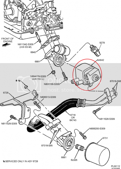

Here are some cooling options I found! They are both alternate mounts. Not sure if you are concerned with the current filter location and / or just cooling but here is what I found.
The part circled in red is the cooler. It would probably be cheaper to go aftermarket. they have it listed for 4x2 and 4x4 but i cant find a pic to see if there is a difference. I couldn't imagine there is! the 4x2 is listed at $113 and you don't wanna know the price for 4x4! LOL! Tasca has the parts cheaper but the site i use has better diagrams.

The fourth or last diagram with the water to oil cooler circled in red is the one I got in my '97. Sgtowing, I would prefer to go with the factory adapter without the cooler in diagram 2 and plumb the Earl's cooler into new hoses in front by the radiator if I didn't already have the Trans Dapt, which will be much easier to set up than trying to install the factory one on the engine while it's in the truck. I ordered the Earl's AN -8 cooler, part# 21608AERL from my local speed shop. The Saab cooler definitely won't flow with the half inch hose from the Trans Dapt. I'd rather have air to oil than my '97's water to oil.
I think my '05 is like diagram one without any cooler or remote, except it's more pointed towards the front at a 45 degree angle. Rburch, the diagrams you posted have been very helpful. I thank you again.
