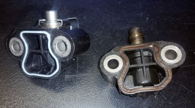

From my research the seals fail in 2 main ways. Sometimes they blow out in a spot and other times they flatten out and start to whither like a pancake. I’m guessing mine were doing the latter since seal sweller helped the situation. The older engines used simple cast ratcheting tensioners that had no problems. Here is the updated tensioner vs an old leaker with the OEM whithered seal.

I think the main improvement is when they started putting a ridge around the perimeter that contained the seal and recessed the O ring on both the cast and plastic ones. They are definitely a one time use item. I am surprised with all the smart engineers out there they can't contain oil under pressure on a part like this.
