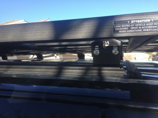

Did you mount it to the factory rack mounts, drill additional mount holes?
The mount points are different for the EL I hear.
I'm lookin to bedline the exterior. What purpose would I have in lining the interior?
ExplorerTom
Apr 2, 2015
2,287
1,039
Colorado
You remove the factory rack completely. The new rack comes with rails that look like this:
You take your factory rails and transfer the holes to this piece so it fits into the roof the same.
The new rack has feet that look like this:
It’ll fit. Trust me. It won’t be listed in a catalog that it’ll fit, but it’ll fit just fine.
