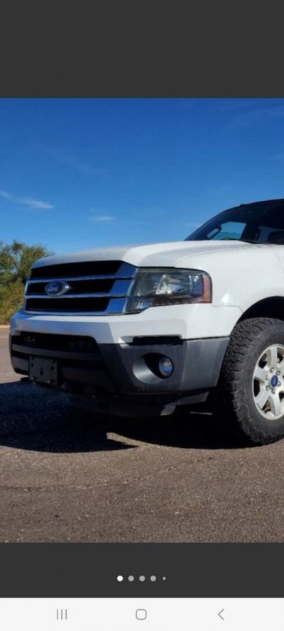

I know this post is old but can anyone tell my why the front bumper on this 17 expy I want to buy looks like the one on my 07? I thought they changed it and the pics I've found online show they did but not why this one looks different.

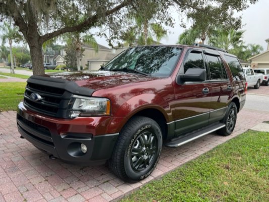

Logan, that looks like the front end of an SSV model of Expedition, also known as the police package. These usually, but not always, also have certain features like rubber flooring, and a column mounted shifter. I have a 2016 SSV with the same front end.BC3B9C21-7D28-42AA-8F9B-37C73E2DECD3.jpeg
