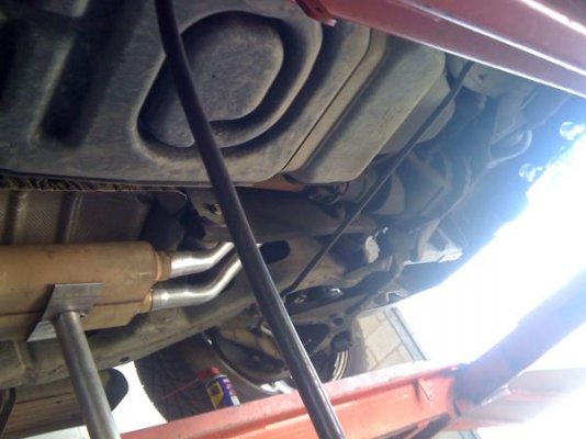

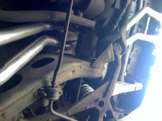

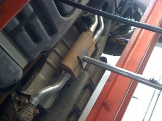

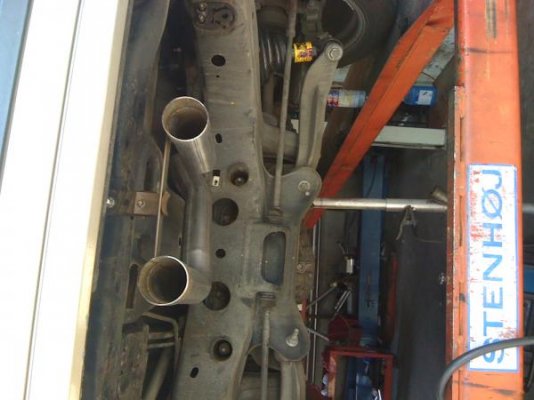

i have a single inlet dual outlet exhaust.. i had to take out the hitch and spare because i wanted it to come out a certian way.. but when the dude ran the 2 pipes he had to do alot of bending and cutting. but he was able to run both pipes out to the back.. if you pay attention on the passanger side i want to say its on the side of the control arm the dude ran both exhaust pipes... the barely fit.. i paid 450.00 for everything flowmaster labor, tips...ect im sure there is a way to fit a dual exhaust system on your expy.. the only reason i didnt run duals is because i hear that on the 4.6L you lose hp.. that it sounds like crap also.. i didnt want to take that risk..you'd have to go to a muffler shop unless youre a muffler man...since ur asking for help...the later doesnt apply....ne way go to a muffler shop...04-06 EBs cant do true duals because of the way they redesigned everything underneath...i've seen 03's with true duals but 04-06 they dont have the room/clearance to run split or side-by-side duals...they tried to use the smallest piping they had and couldnt do it....the left side doesnt have the clearance like the right...cant fit 2 pipes on the right...main reason why WHOISMOOTOO did what he did...i'm going to do it too...
