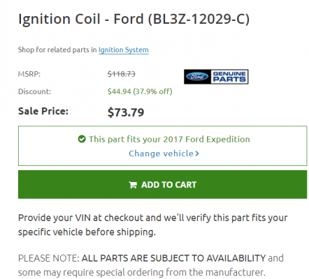

GlennSullivan
Jul 3, 2021
641
364
Yorktown NY & Jupiter FL
Here is the Coil Pack through Tasca Parts - big Ford Dealer so you don't need to be concerned about counterfeit parts. They also sell other OEM brands. I just bought some coil packs for my C6-Z06 Corvette, local dealer wanted $149, bought from them for $85.
