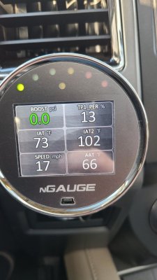

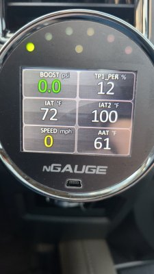

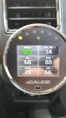

Thanks for sharing! What are your IAT1 and IAT2 temps during normal driving? I'm curious to see what impact the intercooler had. I normally see a 20 - 30 degree increase.
Ok here you go! This was a cooler day for Florida, I will get some more when things warm up. I also got some video of the readings I will post to my IG account. It was rare for the IAT2 to go above 100, only while sitting still.20210108_170805.jpg
