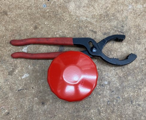

I got these oil filter pliers years ago after starting to DIY maintenance. Needed them because my 5.4's filter is so awkward to access. Is the 4.6 worse?
