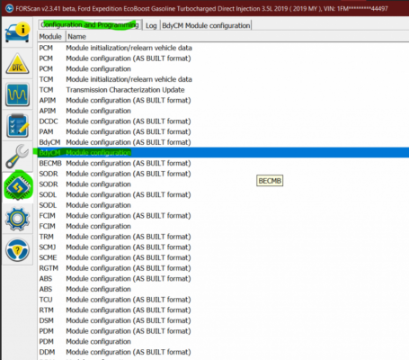

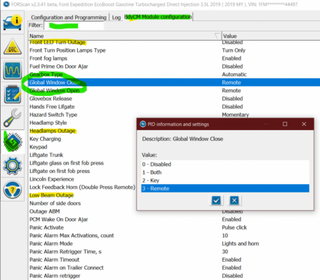

From memory, loading the APIM or BdyCM the human-readable (non-hex) modules looking for bulb outage indicator or something like that and disable it (under halogen outage). Hyperflash will be gone. I tried at first, to disable the halogen & enable the LED outage but that didn't work for my XLT (hyperflash continued).
*Note, I have a MY19 & what you see in ForScan for your MY21 will be different.
Here are some screenshots from an old post of mine. use the filter feature to search for "outage"
