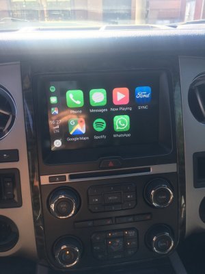

finally got around to installing sync 3 software version 3.0 in my wife’s 2016 limited. Picking up the usb upgrade for Apple car play tomorrow, ***** legit. Gonna be just like the 2019s

Wait till you run iOS 13, it allows you to run one app on Sync and another on the phone itself via CarPlay! Waze on the big screen, FORSCAN up on the phone watching gauges.
