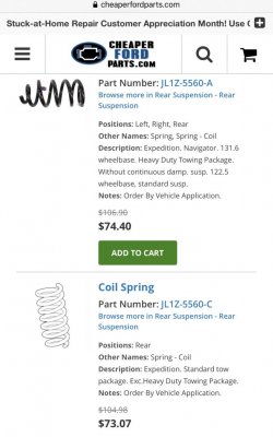

I decided to look at this further and I still think the coil springs are different between with and without heavy duty tow package. I searched for two VIN's online. I narrowed my search to 2019 Expedition Max XLT's RWD. I picked one VIN with heavy duty tow package and one without. I then searched for the rear coil spring on parts.ford.com while filtering for the specific VIN. Below are the results. Notice that the description even indicate as such. Note the VIN's are visible in the screenshots. Also note if searching for two different VIN's on parts.ford.com, it is best to close and reopen the browser. It seems to remember the old VIN in the background.
With heavy duty tow
Without heavy duty tow
I noticed this the other day as well, but the part number is the same for both. I also noticed most the parts for the Expy are back ordered.

Yup, same part number because they are the same springs.

It strange, if they are the same then why is one on back order? And why would they take the time to make two separate links. They could have made one that says for all 18+ Expys. And they would show in stock.

It would make sense that the HD tow got a heavier rear spring. Who knows with the part numbers matching tho....
6,531
3,140
Eh they may be slightly different who knows. You'd have to check payload on comparable models. Often that short number isn’t exactly the same as the long part number.
Parts.ford.com doesn’t show the full PN. If we go to a different site to look up the parts, we see the full part number is different. They both do share the 5560 portion. 047E3FF1-B9E4-4CF5-8C56-25FBDF45C0AD.jpeg
