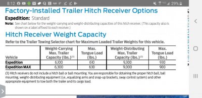

My door sticker (2019 max 4x4 HD tow package says:
GVWR 7720#
FRONT GAWR 3550#
REAR GAWR 4380#
Curb weight (all fluids for normal operation and 90% full of fuel, so 27 gallons) is 5794#
Leaves you with 1926# payload in the expy.
It'll get eaten up in a hurry towing a TT for a camping trip!
FWIW, my camper has 1680# in payload. If I filled water tank full, I'd be right near max for sure...
Need to hit the cat scales to know for sure. That'll be in the spring here...
I’d be surprised if your payload was 1926. What’s the yellow sticker say? Thats the actual payload from factory.
For the OP, Expedition’s will run out of Payload before trailer weight. You have to consider what is added to the Expedition and any persons, animals, or items added in your payload calculation. The yellow sticker on the Drivers side has the factory payload number. That only includes full tank of gas, nothing else.
I have an 2019 XLT, with 1670 Payload. I tow a TT thats empty weight was 5050 when purchased. Trailer is about 850 of that. With family, dog, gear, WDH, etc, I only have about 100 pound of payload left.

Agreed, there is NO WAY an Expy has a 1926# payload. The yellow sticker on the driver door jamb tells it all. As stated before, payload will be maxed out WAY before the mythical max towing rating. An XLT will likely have a higher payload than a Platinum everything else being equal because there are fewer "goodies" loading down the vehicle.

How things are loaded does matter, but about 13% of the trailer weight (camper) needs to be on the tongue or sway will be more likely to occur. There are good videos on YouTube that demonstrate this.
