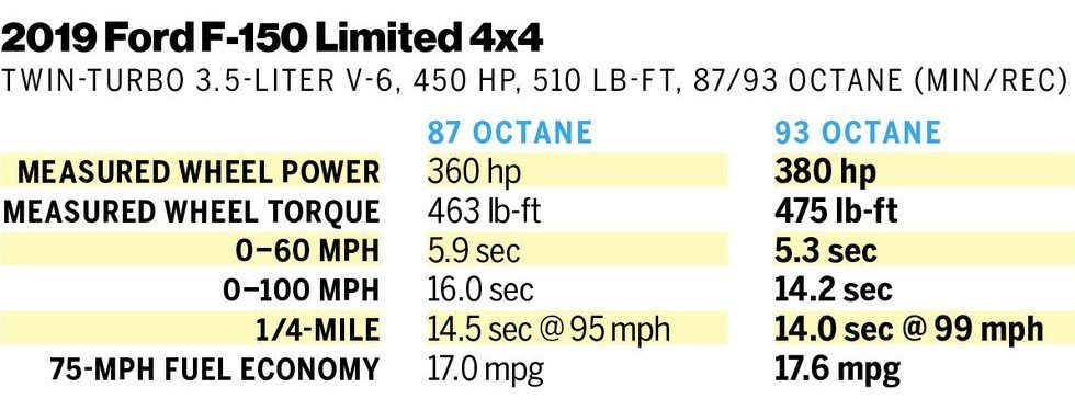

That's interesting. My octane adjustment shows -1 even when I blended the 93 with 87 octane. So is there some other measurement for octane rating that I'm not watching? My recollection is that some value from one of the torque demand lookup tables is multiplied by the octane adjustment to hit max boost and timing, and that the "-1" is as good as it gets.
*edit* here's the article I was referring to about the optimal value for the octane adjustment.
See comment in linked thread below from Livernois regarding 91. Is it not correct?
Jason, Sorry for the delayed response. I just don't get on here as often as I used to.
That -1 is momentary, as in that instance in time. There is a learned Octane value to that is taken in to account. Next time you are running 87, go do a hard full throttle pull and watch that parameter. You will see it change. Watch how quickly it does and how far it moves in the other direction. That is because knock is being detected, and it is adjusting on the fly.
I would hate to disagree with LMS, but I often do! They are not the end all be all on tuning. Especially on the EcoBoosts. I have seen the live data on my own Ecoboosts. There is definitely an advantage to be had with Octane over 91. Also like I have preached on here before the biggest difference in preventing knock and timing being pulled, is Ethanol. E10 89 will perform better than E0 93. E10 87, will perform under load almost as well as E0 93.
You want to run cheaper fuel and have a Sheetz nearby, use the Unleaded 88(Blue Handle, E15), currently cheaper than 87, and will run better in the heat. I saw ZERO loss in MPG when I was using it on my 150. Even if there was a 5% loss, the price difference will easily make up for that.
