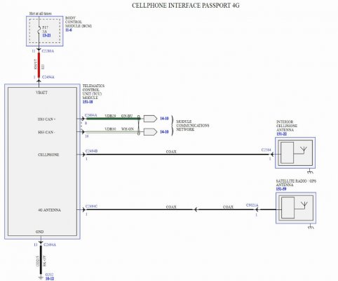

@Edistobob
Check this out. Looks like a 5 Amp Fuse 17. Not sure if that is the interior fuse box or the one in the engine bay. See if it has 12V when the vehicle is off, this diagram states it is "Hot at all times". If that is true, we are going to have to keep digging.
CobraO
Feb 23, 2018
20
Houston
Also found this. You can get to it by removing the center console. Maybe you can back power it directly when the vehicle is off.
