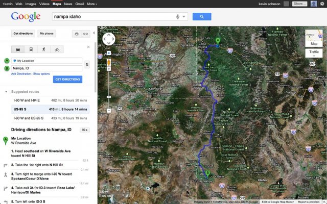

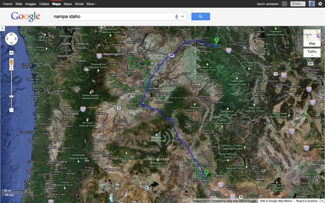

So recapping a whole bunch of my other posts in other threads into this update, and assuming all of you except KWT2000 are Idaho highway clueless, I moved from Nampa to Kellogg ID. Took a job up here selling for Dave Smith Motors. Worlds Largest DOdge dealer, and the Western US's largest GM dealer.. CRAZY HUGE operation.
this is important, to give a parameter of judgement for mileage. If I set my cruise at 5 over, and ran this way:
My 97 Maxima did 27.2 mpg.
If I went this way home:
THe Max did 23.6
THat second route is how she moved up. The poor lil Expy we call Monstro, had a trailer (3000#?) and his entire interior crammed, I had to dig to find the kids, thought she left them....
No rear O2, her tailpipe would make you think she is running MY IDI... and she pulled 14.2. Monstro NEVER gave us 14.2 in an ideal enviroment.
140k+ on I am sure the factory plugs, Lord knows when the air breather was changed, and... it is in a "rich" running mode. Pretty happy.
