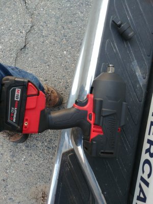

I typically do bearings has a pair because I've had a bearing come completely apart on one of my GM cars so I dont fool around with those. I recently did both fronts because I was doing brakes and IWE's anyway but will be doing both rears shortly. I will say those rear axle nuts were a pain. I was doing rear brakes so I pulled the axle but just to anti seize it while I had access to it. My impact made easy work of it but I tried by had first and it was on there pretty good. I'd try to have a good size breaker bar on hand if I were you. The heavy hitter I used below
Maybe I'll pick up a Dewalt Equivelnt to that, All my stuff is Dewalt 20V so to get a Milwaukee wouldn't be efficient in my case. I've probably got a grand in Dewalt power tools in the expy alone lol, love their stuff. My dad is a Milwaukee guy, they make a good tool. I'm sure that comes in handy.
