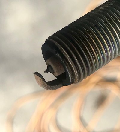

I have 75,000 miles on my 2015. Just changed the spark plugs today for the first time cause I’ve had a miss and rough idle. Fixed it. No other problems so far. I’ve only owned it for less than a year tho

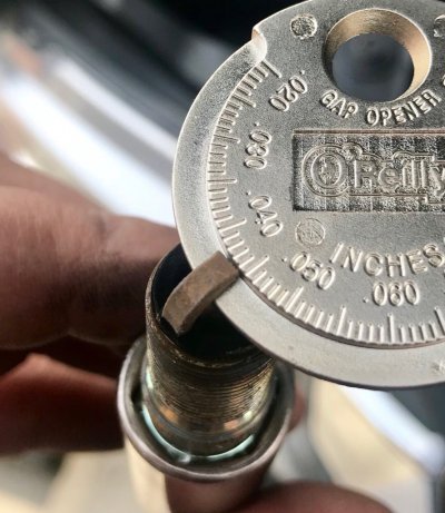

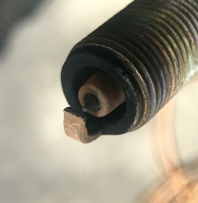

It was easy...worst part of it is my ratchet driver slipped and I broke the handle off my oil dipstick...so now I’m trying to figure out how I’m going to get it out to replace it [emoji51]
I used the FoMoCo SP-534 plugs. I gapped them to .030. The old ones were way more than that...

Those are some pretty good looking plugs from what I can see(I really like to see the band at the bottom of the porcelain) for a Turbo engine with 75K. You can see the ash from the additives in the fuel package on the plug electrode but zero carbon in the fire zone, zero evidence of detonation or lean-burning.....overall, I'd say your engines is in pretty decent shape Muddy. A bit of TB cleaner might have been warranted prior to swapping the plugs but you know what you're doing.....

Hmmm not .028? A lot of what I have read says they should be .028
**edited**
Looks like .028 for tunes
