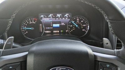

Hey all, have a question for the group. Take a look at the picture below. You may notice the wheel is slightly rotated to the right, but this is when the vehicle is tracking straight on the road. I've tried half a dozen times to take it apart, rotate the wheel partially the left before locking down the bolt holding the wheel in place. There are two guide posts on the steering column that really prevent the wheel from going on crooked, but no matter what I do it's just a few degrees off. Does anyone know of a trick to get this straight again? Or is it a ridiculous matter of getting an alignment?
I know, it's just a few degrees, but it drives me nuts that its not perfectly centered while tracking perfectly straight. Would love some ideas.

@LokiWolf and @DWs-TTEB - you two seem to be very familiar with these vehicles, do you have any advice on getting the steering wheel perfectly centered again after putting the raptor wheel on? Or would this really need the extreme of an alignment? I've tried probably 6 or 7 times, holding the wheel slightly to the right while torque-ing it down. Doesn't seem to make a difference.

Before a professional alignment I’d try the DIY alignment by turning the tie rods and seeing if that does it. YT is full of these.
if that does do it, still recommend the professional alignment (get all 4 wheels done since your there).
