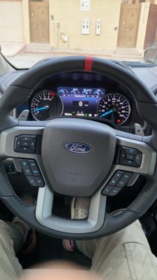

Hey all, have a question for the group. Take a look at the picture below. You may notice the wheel is slightly rotated to the right, but this is when the vehicle is tracking straight on the road. I've tried half a dozen times to take it apart, rotate the wheel partially the left before locking down the bolt holding the wheel in place. There are two guide posts on the steering column that really prevent the wheel from going on crooked, but no matter what I do it's just a few degrees off. Does anyone know of a trick to get this straight again? Or is it a ridiculous matter of getting an alignment?
I know, it's just a few degrees, but it drives me nuts that its not perfectly centered while tracking perfectly straight. Would love some ideas.

I also installed a Raptor steering wheel
I notice the steering wheel turns a little to the right while the vehicle is straightening

That's exactly like mine. Frustrating. I have another warranty service scheduled for next tuesday, told them I'd like to try an alignment. I'll let you know if it helps. It makes no sense that it's off like that, nothing else in the steering changes, so i'm wondering if the actual cast between the wheels is a little off. Love the wheel though. I was actually playing around with the paddles today. It's really interesting to see the power bands and when/how the turbos kick in. Never really noticed it until I started driving with the paddles. It's not at all like my previous turbo'd vehicles.

The steering wheel on my 2020 shorty is titled about 5 degrees to the left at 5k miles (at about 830 and 230 instead of 9 and 3). Such a small thing but really bugs me sitting behind the wheel on long trips. Did anyone ever find a remedy to the situation? I dont mind paying the $100 for an alignment if that fixes the issue; my knowledge is pretty limited but since the wheel "auto centers" itself crooked, and the vehicle drives perfectly straight with my hands off the wheel at that (off) centered location, my thinking is the alignment is fine but the steering wheel is just off somehow?
I remember reading somewhere on here that the electronic steering has some sort of learning functionality that takes a bit to "re-learn" after the battery is disconnected. I'm going to try that tonight and see if maybe that electronic reset will bring it back to where it should be.
Will report back on that but in the mean time if anyone found a solution, or if an alignment will take care of the issue, any input would be appreciated!

An alignment on mine fixed the wheel center issue. Technically its one of several things they do during an alignment, so even if the other stuff is fine, they can still straighten the wheel. They actually did mine at no cost, as I told them the same things you did, and there were no obvious signs of impact or anything else, so the dealer took care of it. I wouldn't mess with the Forscan stuff.

Just a follow up. I installed the wheel and went for a drive. As others have mentioned it is about 2 degrees off to the right. As I’m like most it bothers me, so I did some tests from the stock to this wheel. When installed both wheels there is play from right to left before tightening the wheel with the center bolt. I’m guessing like everyone when we tighten the bolt the wheel pulls right unless you have someone helping you. Since I noticed the play before tightening again I moved the steering wheel as far left as I could do by myself when tightening the bolt. That seemed to fix the wheel 99.5%. To get it dead straight on you need another person just to move the steering wheel a tad more to the left.
hope that helps
