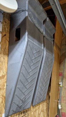

Any recommendations for ramps when it comes time to do the front? I threw out my last ramps when I moved from Colorado to Georgia because they slid out from under the tires. Had to use a 2X4 against the garage wall in order to get my Camaro "on board".

I used ramps on the front to install them but when I put the end links on I didn't, but that's because I wanted to be exactly sure on the length of the end links before I cut them. I would recommend ramps just because it's a little easier to get right under the bar to hold it in place. I held it in place with a forearm while I started threading the nuts by hand. The front is substantially heavier, last thing I wanted was it falling on my face. Be sure to loosely put everything together, bounce the vehicle a few times if you can, that start to tighten it up. The bouncing can help it self center a little.

Thanks for the suggestions. I always say "I need all the help I can get". :) What type of ramps are you using and do they work well with the Expy?

I use a set of Blitz Rhino Ramps. These are older ones but they say they are rated to 8k pounds. I've had them through 3 different cars and they are still great. I will say, the diameter of the tires on these expy's is such that they barely fit on these ramps. You have to be 100% sure it's firmly in place front to back, chock the rear, etc. Once I get my rig back, I'm planning on doing a ton of work under the car, so I will likely put some jack stands under, just as an added measure.
The only other thing with these, is that even though they have the rubber pads underneath to keep them from slipping, I put my expy in 4wheel, otherwise they tend to push out. But secondarily, having it in 4wheel tends to make me feel a little safer, preventing roll.

Gave a set of those away as to me they were more for a car than a truck. Have a different set that has room to spare and are higher as they are designed specifically for a truck. Had them for years so not sure if the brand at this point.
