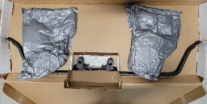

from tip to tip, they were identical, within about a 1/4". The bolt on these is roughly 8 3/4" long, the factory ones I pulled off are close to 9" long. I think it's also deceiving because of the continuous metal piece, vs the factory ones with the flexible bushings on them.
Honestly, you'd probably get some handling improvements out of just the rigid end-links with the old bar. I ran the ES poly end links on multiple previous vehicles and each time it sharpened up the handling noticeably. I think the main reason manufacturers avoid them is because the bushings do wear over time and will squeak as they do.

And they may, the fact is, the whole setup from Energy Suspensions was about $25, and if the bushings do wear out, a whole new set is less than $10. I agree, Having driven it a couple times since putting them on, both make for a pretty nice ride.

Sounds like another wave of bars. Ordered mine on Dec. 8. Rear shipped out today. No update on the front yet.

Just got a UPS notice that My rear bar should be here before the weekend.
I postponed ordering a front bar until I see the improvement from the rear bar alone.
