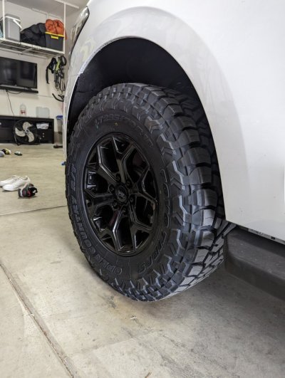

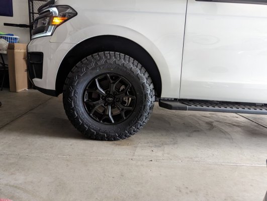

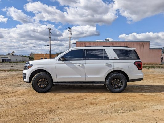

leirej
Apr 6, 2023
SoCal
Looks great. I almost went that tire and rim but went 17 with 305s. Toyo Open Country. Toyo Tires are great and pretty quiet.
By any chance did you fix the speedometer? I'm about 3 mph off. Tried to run forscan but it says it doesn't recognize my vehicle. I guess there no support for the 23 Timberlines yet.
LazSlate
May 7, 2022
416
245
Arizona
No support yet. I do not mind the spedo off as long as you remind yourself it reads slower than you are actually going.
In the long run you will have a lower odometer reading for same miles driven as if you had stock tires.
