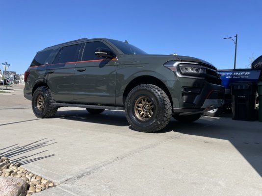

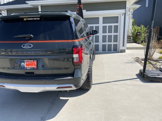

295/70 R18 Toyo Rt Trail on stock Timberline rims and suspension. Didn't have to trim or move anything. Haven't noted any rubbing with normal driving. Thank you to earlier posters with their setups.
Wow, I don't think I ever paid too much attention to the stock timberline rims but those look really good. I'm happy with my selection because it matches my paint better but if I'd gone with my other options of a black or white Expedition, those would be my choice. Looks great!

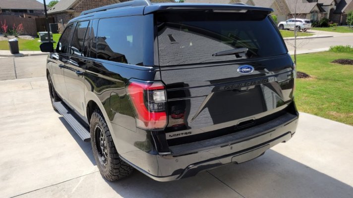

Finally swapped the factory 22s (285/45r22) for 18s from KMC with 35mm offset. I've always had good luck with Nitto Ridge Grapplers, so that's what I wrapped them in.
New tires are 275/70r18 (33") and fit great with no rubbing.
Chrome delete is up next for the weekend project.
That looks awesome!
GixxerJasen
Aug 8, 2022
559
524
DFW TX
Did you paint your decals black?
If you are talking about the raised lettering, they come that way from the factory on the Stealth package. However, somehow stealth still meant a chrome beltline. Stupid.

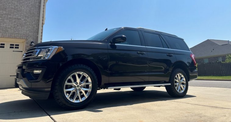

Lift : Bilstein 5100 F150 struts bottom ring/5100 Expedition rear shocks top ring
Tires :Toyo Open Country AT3 275/65r20 (34.1 inch tall 11 wide)
Rims: Factory 20" with Rough County F150 2" spacers
Does it poke? Yes a little
Does it rub? Yes front tires in front and rear of the tire.
need to pull/adjust fender liners back.
View attachment 41555 View attachment 41557 View attachment 41558 View attachment 41559 View attachment 41561
IMO one of the best looking I’ve seen. Perfect combo!!!
