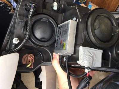

I went through two sets of LEDs that really didn't give me enough Light down the road then I switched to an 35W HID set using canbus ballasts. I posted a bunch of pictures on other threads but I'm not not going to post then again. You can find them if you search my user name and HID as a keyword. This is what I'm using and very happy with. https://www.xenonhids.com/35w-ac-canbus-ballast-hid-kit.html
I would have liked to LEDs but they just didn't work in my projector housing.
