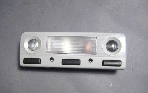

Next I did a mod I have been planning since I first started working on this truck. Get some better interior lighting up front. This is a dome light/map light module from a 97-2003 BMW 5 series:
It has a dome light, a map light for each side as well as LED "mood" lighting. Two directional LED's shine down on the center console area and front seats so you can see what you are doing at night without turning on the dome lights.
Here it is mocked up where I wanted it on the overhead console.
A little time with a dremel later and it was mounted in the console.
The LED's are wired to come on with ignition in run position, the rest of it works in conjunction with the other dome lights. The front is illuminated a lot better now when the doors are open and the map lights in this thing kick ass, they actually focus light where you need it. The part itself is not a perfect color match for the interior but it blends in well enough for my tastes.
