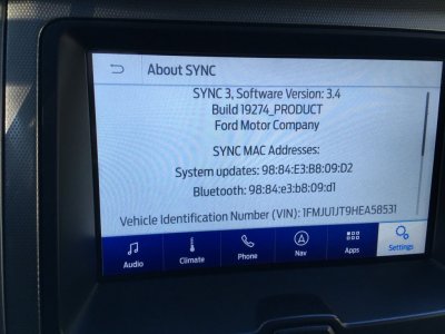

I successfully upgraded from 3.0 to 3.4 today using the instructions on the Cyanlab link near the start of this thread.
Observations:
  • Once you get 3.4.19101 installed, make sure to do the suggested factory reset. If you don't, some of your settings won't migrate over cleanly and can result in funky behavior.
  • As long as you store each downloaded Sync version separately on your laptop/desktop, you can easily get away with two drives. After I installed 3.4.19101, I cleared that flash drive and copied 3.4.19274 down to it for the second install. Technically, you could do this on one key drive, clearing the reformat (first, short install) and copying 3.4.19101 to the same drive. The system can't boot after that reformat and will wait for a key drive with an install on it forever. Having two or three certainly saves trips between your computer and Expedition, but it's not a requirement.
  • It looks like 3.4 enables a lot more FordPass functionality over the Bluetooth connection than 3.0 had. On my 2016, even a USB connection enabled little more than vehicle information in FordPass; in 3.4 there's a lot more to play with.
2016 Upgrade Path
Sync activity since I bought my 2016 Platinum two months ago:
  • Updated from Sync 3 1.0 to 3.0 (downloads from Ford)
  • Upgraded to AirPlay-enabled USB hub
  • Updated from 3.0 to 3.4.19101 (downloads from Cyanlab; link here)
  • Updated to 3.4.19274 (downloads from Cyanlab; link here)
Note that my 2016 came with Sync 3 (version 1) from the factory. 2016 Expeditions with Sync 2.x (four quadrant screen) are SOL.

Do not need to do a factory reset between, just a reboot.
