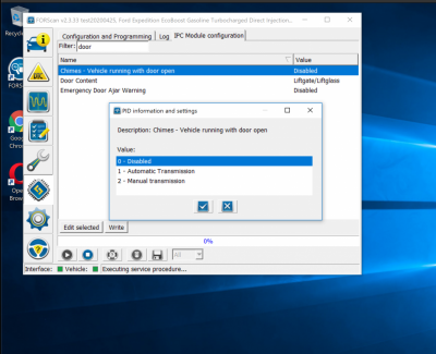

Good info @LokiWolf, thank you again!
I was able to get the door chime disable now too - using the IPC Easy config by changing
Chimes Vehicle running with door open - from manual trans to disable.

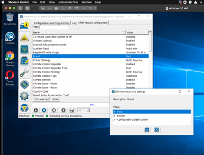

screwing around last night I learned some stuff (purely by accident as per usual).
Im struggling to obtain the infotainment fast boot (no splash screen, no ford oval).
specifically (as discussed w/ @Lou Hamilton) from another thread I was wondering what the "C" option did in the APMI settings.
In the EASY config there is BRAND option (Ford, Lincoln or Configurable)....thats where the C bit comes in.
which allows you to select the splash screen you desire.
APIM - 7D0-01-02 **** xxxx xxxx Brand: 0=Ford, 8=Lincoln, C=Configurable Splash Screen (This is actually for the theme)
APIM - 7D0-02-01 xxxx x3xx xxxx Lincoln Black Label start-up screen
Once the C bit is set you can then go to the SPLASH Screen and change to one of several listed.
Im still struggling to set NO splash screen, always get the ford oval (or something else).
Screenshots as promised -
The bronco them is kinda cool.
