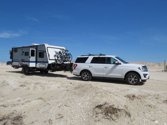

So after hitting the scales a couple of times I'm trying to decide if I should perhaps trade in for a 3/4 ton (and suffer on mpg) or not. My wife would let me have it as well. Towing capacity is not an issue for me as the 30' TT weighs in at 7500 lbs, but my GVW, drive axle and front axle come in at (7240 lb) 99%, (4280) 98% & (2960) 88% of capacity respectively. I'm still playing around with the WDH and should be able to shift some more weight to the front axle. What's frustrating is it tows great with no sway or power issues. I do worry about premature wear and tear as both front and rear brake pads have already been replaced (under 45k mile) and the cam phasors were also just replaced. It's tough space wise with 3x kids and 2x 50lb dogs on long trips driving late at night, we'd have to go with a Ram mega cab (reclining rear seats) which adds 3' in length as well. Ugh. We do one 2000 mile RT per year so that accounts for 1/4 of the trucks odometer reading. The remaining few trips are more local, and the other trailers I tow are well within specs. IMG_3604.JPG

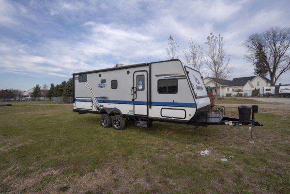

That trailer is 30' long? Weird, seems smaller in the picture. What is your tongue weight? Bikes on front of camper isn't helping. I'd move them to the rear. Move things around, avoid heavy items in that front storage. Do you dry camp alot? Can you get buy with just one propane tank?

The camper has a 2' cargo rack in front (note the 3rd bike on it) plus a long 3' tongue, so it's deceiving. TW is at 788 lbs, so I really can't remove much more or I'll go under 10%. Also I have 2 bikes on the rear of the camper. It's a delicate balance as I can't add any more TW either due to the truck GWV and rear axle limitations. The Expy is a 3rd vehicle, used mostly for trips or when we need the space. About half of it's miles it's towing something - 18' boat, landscape type trailer, etc.
