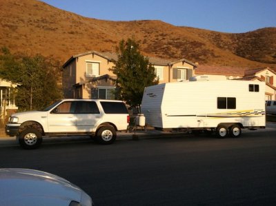

I recently became the proud owner of a 1999 Ford expedition 5.4L Eddie model 4x4
(got it for 1750 from Father in law) wanted to keep in family...
I recently moved back to so cal and everywhere i ride your best bet is a 4x4 (Glamis, Pismo) so its a win win for me...
Brief History on Truck Had Spark plug issue about 2k ago they recoiled it
everything has been well maintained on truck
Has a K&N intake,
My question is....
Do i need to upgrade tranny pan, diff pan, sway bar, electric water pump, exhaust, chip?
Truck has 163,***
Trailer is Dry Weight 3400lbs 21ft
I load her to about 5500lbs then to about 6k for about 20 miles( i fill up once close to camp)
Just read dry weight is different then unloaded weight i will double check that weight to be certain
I would love to hear from those who tow similair to what i do and take same routes, I-10 to glamis, or 101 to Pismo or Cajon Pass to Barstow?
Haven't tested her yet but my date is coming soon, want to be prepared.

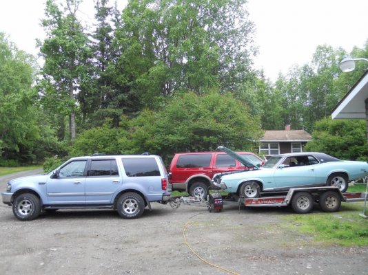

i would def add a aux tranny cooler, make sure everything is in good working order and thats about all you can do.
i towed 5,700lbs this summer and i have to say the truck handled it great!

I am not seeing equalizer bars?? That would bring your front end back down!

Yes I do have equalization bars
The list kit is 6" in front and 4" in rear....so it sags already...
