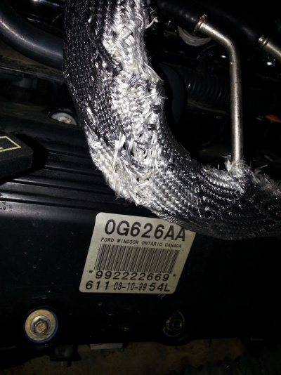

Greetings all,
My 2000 Expy has a replacement engine in it. I took a cell phone pic of the identification sticker, but after poking around on the net, I can't find a site where I can enter the info and find out what engine it is. I am wondering if my engine is a little sluggish. The thing has a lot of grunt, but my Expy won't do a burnout. Perhaps that's just the way they are? It's my first Expy, but not my first Ford. After 3 Mustang Cobras, I'd like to smoke the hides once in a while.
Here is the pic:
Thanks in advance for any help!

If you want to spin your tires, go find a gravel or dirt road. As for your engine:
The first character is a zero - 0g626aa is the correct search for what it is. Appears to be a short block 5.4L V8, which makes sense, right?

From the sticker you can see its a 5.4 Windsor manufactured on 8-10-99 so its a PI 2v motor which is what they used up until the 3v was introduced. (260 HP) 97-98 were non-pi. Not sure what else you would want to know.

Thanks for the replies. I pretty much figured that the engine was right, just was curious if there were any variations of the 5.4 between truck an Expy.
