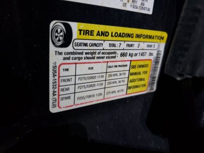

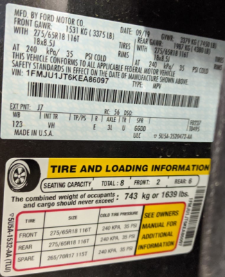

Can we talk HD Tow one more time?
Meeker
Apr 3, 2016
281
165
Calgary, AB, Canada
Code:
Year Trim  Length 4wd FX4 HDTow PanoSR Rim Sits Payload GVWR FGAWR RGAWR User
2019 Limited  123 Yes No  Yes   Yes    22  7    1553    7450 3375  4380  Lou Hamilton
2020 Limited  123 Yes No  Yes   Yes    22  8    1482    7450 3375  4380  Eric Mowrer
2019 Limited  132 Yes No  Yes   Yes    22  7    1647    7720 3550  4380  byathread
2019 Limited  132 Yes No  Yes   Yes    22  8    1629    7720 3550  4380  BLUWAGN
2019 Limited  132 Yes No  No    Yes    22  _    1619    7720 3550  4380  GB19XLT
2019 Platinum 123 Yes No  Yes   Yes    22  7    1487    7450 3375  4380  Flying68
2020 Platinum 123 Yes No  Yes   ___    22  7    1537    7450 3375  4380  Matthew Marlowe
2018 Platinum 132 Yes No  Yes   Yes    22  7    1585    7720 3550  4380  Saltwater Soul
2019 XLT      132 No  No  Yes   Yes    20  8    1613    7400 3300  4380  wakeboarder
2018 XLT      132 Yes Yes Yes   Yes    18  8    1671    7720 3550  4380  shane_th_ee
2019 XLT      132 Yes No  Yes   No     20  8    1767    7720 3550  4380  Joey Smith
2019 XLT      132 Yes No  No    Yes    18  8    1676    7720 3550  4380  DWs-TTEB
2020 XLT      132 Yes Yes Yes   No     18  7    1905    7720 3550  4380  sanman28
2018 XLT      123 Yes No  Yes   No     18  8    1633    7450 3375  4380  Meeker
