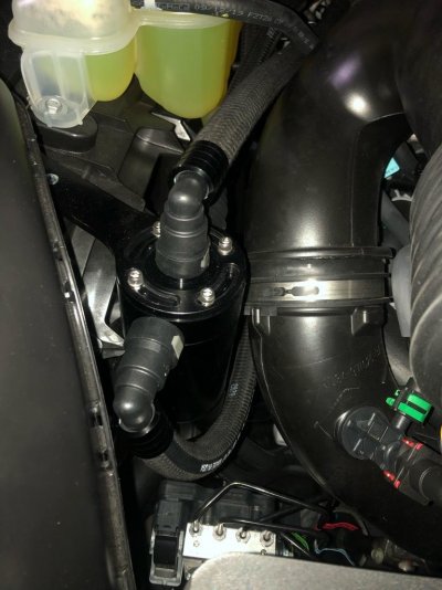

Mine is mounted to some metal more toward driver's side. Looks easier than what they had you do.
These are the connections coming from under the engine cover and the one one the air intake.
