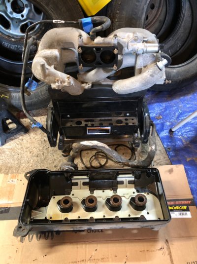

The only thing my untrained eye noticed is what I tried to capture in this pic. To the bottom left of #8 (looking at it from the fender), I noticed something that looked like it used to have something attached to it like all the others. Am I right? Is this bad? Please tell me it’s not real bad!! The springs looked OK to me. Would it be very obvious if a spring was bad? I mean, none looked broken from what o could see.

Here’s a shot of the whole thing in case anyone wants to have a look at this difficult 4v!!

Maybe a unseated Cam follower. However, it would be laying somewhere and you would see it. Its not #8. It could be stuck near the valve spring and holding it open. Your arrow is pointing to a lash adjuster.
stamp11127
Mar 10, 2012
6,207
1,246
Temple, Georgia
If that roller follower isn't in the cylinder head somewhere, that means someone else has been in there in the past and removed it for whatever reason.
I would inspect the cam for that valve looking for grooves, chips and cracks along the surface. If any are found the cam should be replaced. If you just install a new roller follower the cam would slowly grenade over time.
If there isn't any damage then you can replace the roller follower. Use assembly lube and coat the contact surfaces prior to assembly.

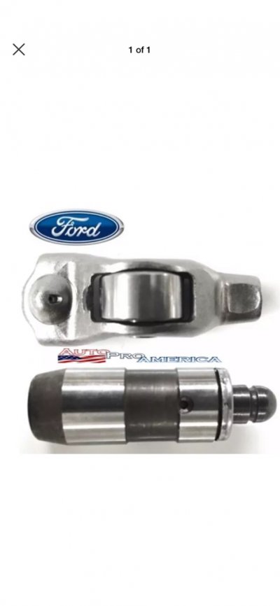

Found a loose part!! I’ll have a closer look tomorrow to make sure I don’t see any damage. Is there a piece that was on this that I still need to find? I think it is supposed to look like the pic I found from a search-so I assume a piece broke off of it and that is why it came loose?
From a search:

They held on by pressure only, no fasteners. If the top end is starved of oil, too heavy oil is used or over reved, they can come off. Was it interfering with valve on the bad cyl? Just put it back on. Make sure the roller is not damaged.

Check the valve spring. If it broke, would explain the compression loss and the roller coming off. Can you see if the timing chain is tight. That's another problem with these motors. Bad tensioners

Girl, here's a great video on installing these in a later model 5.4. Probably the same with yours. It explains what this is all about. As was said, you'll want to use some heavy grease on this to protect them when the motor starts up and you want to check that valve spring to look for a break in it... A broken valve spring is one cause of them flying out. Also make sure the roller spins freely and there are no chunks out of the cam or roller. The tool is about $20 - $30 and makes the job easier by compressing the valve spring.
Do your homework if you have to replace a broken spring. There are a few tricks.
