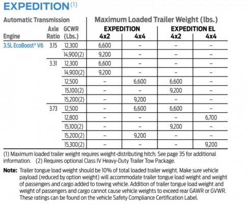

My understanding, based on this 2017 towing guide, is that with the HD tow package (TBC and 7 pole electric are the most evident with a quick look, but it also includes auxiliary trans cooler and maybe a bigger radiator) you’re good for 9200# with a WDH regardless of axle. Hope this helps 99399814-F6E0-46C9-9EEB-DFDCD44B557C.jpeg

My understanding, based on this 2017 towing guide, is that with the HD tow package (TBC and 7 pole electric are the most evident with a quick look, but it also includes auxiliary trans cooler and maybe a bigger radiator) you’re good for 9200# with a WDH regardless of axle. Hope this helps View attachment 72178
Thanks for the input. I was under the same understanding as you map out, but started to question myself as I did more research. Would be interested in hearing other people’s opinions on this as well.

The HD Tow packages will all be 3.31 or 3.73, depending on 4x2 or 4x4. Either is fine for towing. I tow 7K with the 3.31 and have no issues keeping up with traffic.
I wouldn't go any higher than a Limited for payload reasons. A sunroof also takes a chunk out of the payload. I can't answer your question as to how much payload is enough because I don't know how you'll be loaded up, and I don't know if your weight is wet or dry. But assume that 10%—or conservatively, 13%—of the camper weight, as well as the hitch weight, should be subtracted from the payload.
If your weights are configured correctly (tongue, payload, and axle) don't worry about the sag. The Expedition doesn't require a weight distribution hitch (WDH) unless over 6,600 lbs, but you should use one anyway because they frequently incorporate anti-sway as well, which you'll definitely want with a large camper. The WDH will take care of the sag.

I think some of the confusion is due to the "when properly equipped" wording, which basically means "when using a weight distributing hitch." So to get the 9200lb towing capacity you will need both HD tow package + a weight distributing hitch for the trailer. The axle ratio does not change towing capacity. I have HD tow with 3.31 gears and it works just fine, I haven't found myself wanting more gearing.
Regardless I would definitely recommend the HD tow package if you're going to pull any sort of travel trailer since the weight is only part of the equation. The other, probably more important aspect, is the frontal area of the trailer, 60sqft for HD tow vs 36sqft: See pages 15 and 28 - https://www.fleet.ford.com/cmslibs/...eet/towing-guides/Ford_Linc_17RVTTowGuide.pdf

No, both a WDH + HD tow package is required to get the 9200lb towing rating. Without either HD tow or a WDH (or both), it's limited to 6600 lbs.
The payload is static and depends on vehicle options. It comes into play for the tongue weight, so payload rating - tongue weight = amount of people and cargo you can carry.
