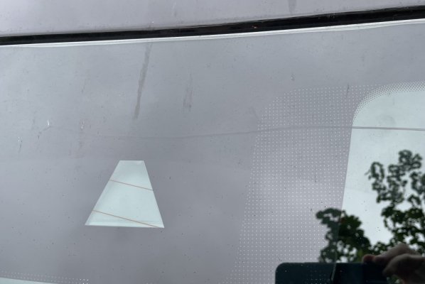

This crack (seen in the photo) appeared out of nowhere this morning while parked at a gas station. It appears that the crack is “inside” the windshield glass - it’s not on the surface on the inside or outside of the vehicle. It also appears there is something loose inside this housing behind the mirror (I’m assuming this is where the Cruise Control Sensor is located).
Has anyone else experienced this? Should I expect this to be covered under warranty? The Expy only has 7,000 miles. I’ll be calling Ford tomorrow, but wanted to be prepared for whatever they may say.

Yea, that definitely looks like a failure of the glass itself and not damaged by an outside source (rock).

I have a similar funky crack at the base of the windshield that starts under the cowl and comes up 3 inches, across 8 inches and back down- dead center. It's totally hidden by the wipers. Seems like a defect.

I was able to take a closer look today. There’s a small nick in the glass where the crack spiders outward from; probably from road debris and then just cracked later. Safelite will be replacing tomorrow through my insurance. I just hope they do a decent job.
