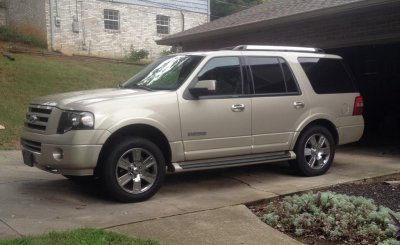

Hi guys,
I wanted to level the front of my 2007 Expedition. I think everyone knows that the leveling spacers are the least expensive, but the worst way to level if you want to keep your ride quality.
I took a chance and bought the Bilstein 5100 shocks for the F150 that have 3 height grooves machined into the shock body. You can put them in at 0" lift, 2" lift, and 4" lift.
Here is the link that explains why the spacers are the wrong choice:

The ride quality is same as original. The Bilsteins are great shocks, so a very damped ride. My car had 100K miles, so the original shocks were blasted anyway. New shocks are the least expensive way of getting a huge improvement in your vehicles ride, handling, safety, etc.
You cannot lift the front 4"!!! The top upper ball joints will bind, then break, then you crash and die. With these shocks, the upper b/j do not bind (i checked mine on the lift before driving).
I'm not an expert, but with the weight shifted some to the back, full suspension travel, and high quality shocks, I believe the Expedition rides better than new.

Your truck looks a little too high in the front. Just sayin'.

At first the front looks high. The front wheel arches have more gap than the rears. but, the truck is level. I put the fronts at 2" higher. The F150 strut is about 1/4" longer if I remember right, so essentially nothing.
