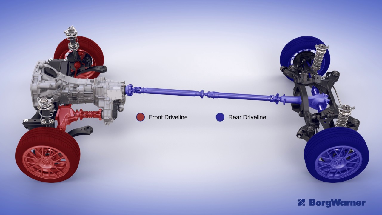

Here's a video showing how the transfer case works. Note that the most you can get is 50% front/50% rear. But it's infinitely variable from 0% - 50% front torque. Of course that's when the software comes into play - how they decide how much to put on the front wheels is not easily determined...
chuck s
Dec 20, 2006
1,990
753
My dogs and I just watched the animated video. None of us understood how it works but all of us accept that it does. :)
Use of 4H or 4L on a surface with high traction will result in axle/driveshaft windup and a large BANG will alert you to this fact as a tire breaks traction. For me this makes 4A especially valuable on suspect surfaces.
