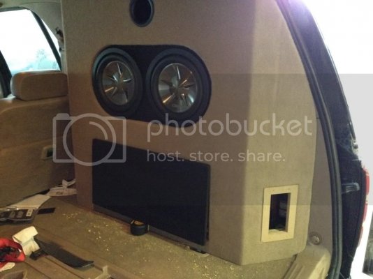

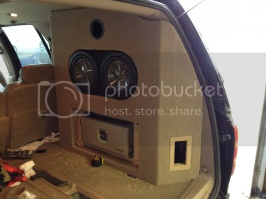

Nothing all that amazing to report. Built the ports for the boxes, i had to cut up the carboard tubes taht came with the ports to make a 90 degree bend in them and then fiberglassed them together. Also Blacked out the back windows, you could see the backs of the boxes in the sunlight and that just looked plain bad. So some back vinyl and its all good now.
I am finally tonight picking up the hardware to mount the subs in the boxes, Tee nuts and 1-1/2" bolts (32 of each). I have to mark and drill the subs enclosures BEFORE I glue on the cloth to the face as they probably wont like being drilled after.
