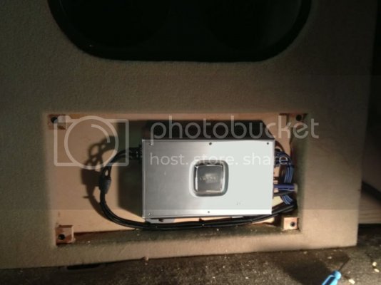

Took some time out from my install to help a buddy do his. In particular the front stage upper pods. Came out pretty good and sounds wicked.

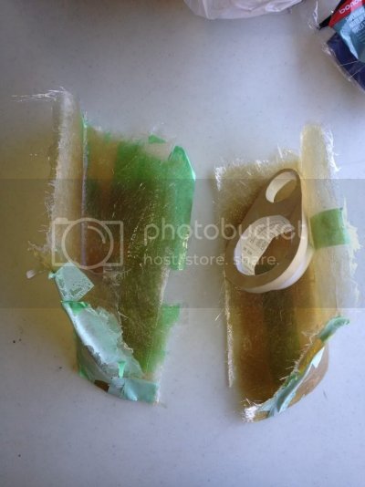

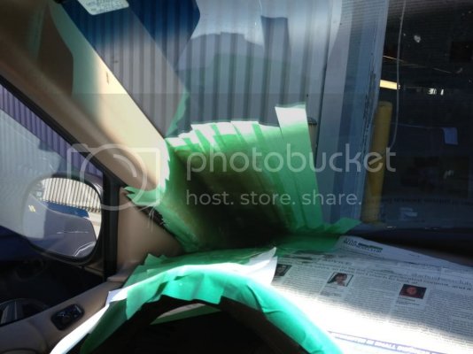

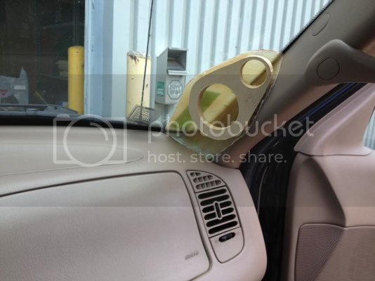

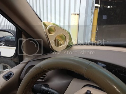

Bringing this back from the dead finally, cut the pillar pods plates yesterday, cutting the door panels tomorrow. Today I will be removing the pocket from the bottom of both front door, which is a pain because they are plastic spot welded in about 16 locations that need to be drilled.........
oblivion
oblivion
Apr 7, 2011
362
26
Ontario Canada
pods are starting, a glassing we will go.........
I am drilling out the plastic welds on the door panels for the lower pocket now.
