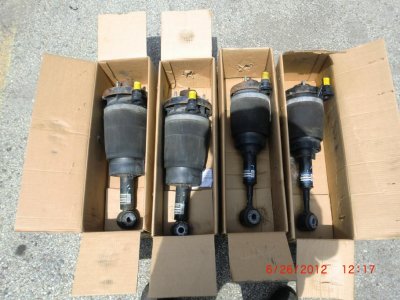

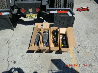

my suspension was working , but old and tired , and shocks was shot , soo I did monroe conversion .
pics 1 kneel down
pics 2 trim height

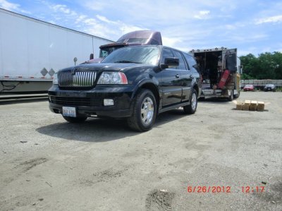

pics 3 after , front 1 3/4" higher , rear 1" higher

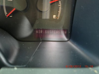

pics 4 display :Violin:
did some playing with sensors , no message at start up , only after 15 minutes of driving , check suspension message pop out , only once.
ride is good , very good , no HUMMER syndrome , just SUV ,
I do not care what people saying , conversion works!
