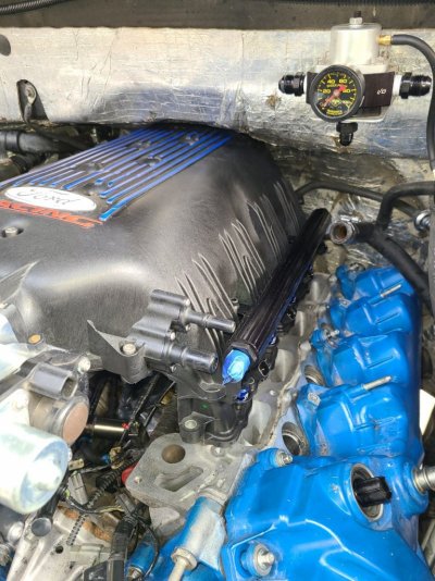

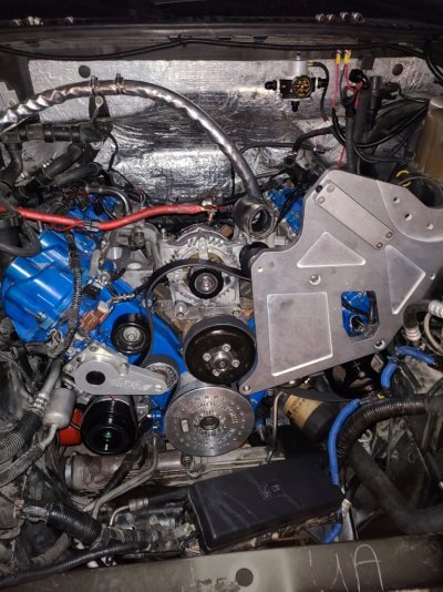

4.6 3v intake manifold im dropping into my 5.4 3v...

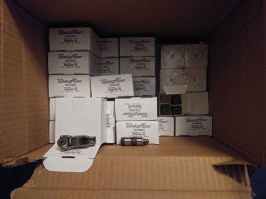

Trick flow hardened steel lifters and followers...

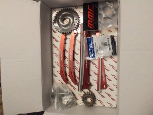

Every last billet part Mmr has to offer for under the timing cover...

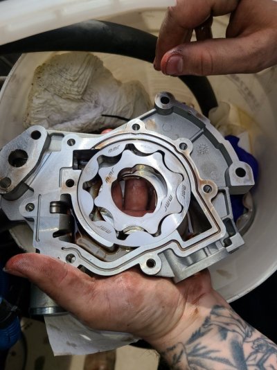

Billet mmr oil pump gears for the melling hv 360...

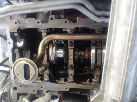

Did i mention full forged rotating assembly? H-beam rods, low compression forged pistons, Arp studded from top2bottom...

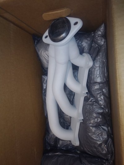

White lighting molten ceramic coated Banks shorty headers with super thick flanges...
