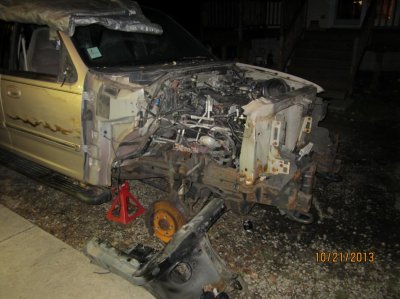

I will try and attach pictures

Thats a bummer. While it is all open like that, I would maybe consider pulling the heads and cleaning the combustion chambers (carbon build-up). Can't really ask for much more room to work than that.

OUCH!!!
That looks more painful than my front end work was.
To address your first questions, sounds like one of two (or maybe two of two) very common issues:
Weak ignition coil(s)
bad/leaking PCV valve/hose assembly
And based on the above pictures, now would be the time to change those items - very easy access now, as compared to when it's all back together.
