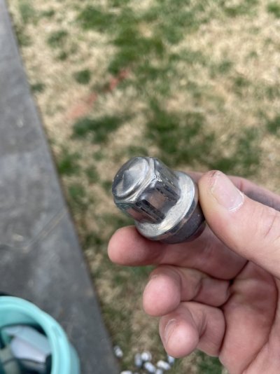

Thanks for jumping to conclusions, this is the first time I’ve ever put a wrench on ‘em but I’ll definitely be having a conversation with the tire / brake / alignment shop I’ve been using for the past 10 years. The old ones were pretty beat up and all of them were swollen to some degree but 13/16 did the trick and fit the replacement Dormans perfectly.

Currently replacing my lug nuts with solid ones. This is what you have to do to at least one just about every time you remove gen stock ones.
This is super helpful!!! I was unsure why I couldn't get the front tire off of my new to me as of yesterday 2007 Expedition EL LIMITED. No matter the socket or even the stock lug removal tool I couldn't remove the lug nuts. I'll update ya'll when I get mine replaced with the link that you provided!!

In theory capping them with stainless steel would keep them from rusting but in application, using short sockets is what eventually destroys them, because it twists only part of the cap, eventually making it impossible to get a socket on them because of the deflection of the cap.

The lug nuts on mine are swollen and over tightened. I just sheared the factory supplied tire iron!! Once you get the chrome off what’s the size of the nut?
