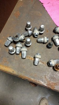

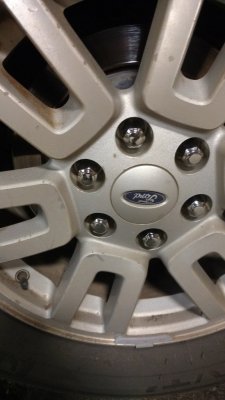

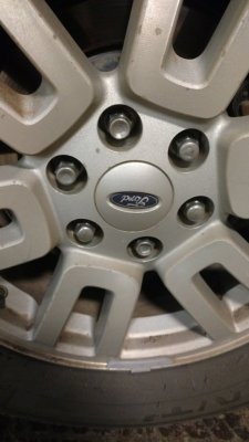

Did this today finally. Worked great. Glad to have those old crappy lug nuts off my rig!
Old Ones:
New Ones:
You can see the dents in the ends of the old ones. That's what happens when you use a punch to beat them out of the socket after you have them off....

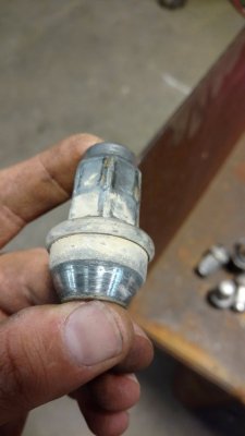

Here's a pic of an old one, and how the chrome cap is held on:IMG_20180414_112703535.jpg

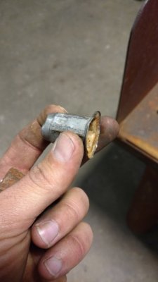

Little work with a grinder:

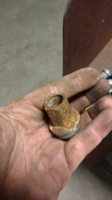

And what's underneath the cap:
Anyone want a set of good used lug nuts? OEM Quality! Priced at half of new! I'll even throw the one without the cap in for free! LOL

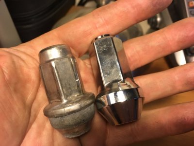

I bought the Gorilla solid steel chrome plated lug nuts & started installing them. $105 for 24 pieces, no tax or shipping. They look great (so far so good) and IMHO an improvement over OEM. Picture at the end, showing one OEM nut I removed is already splitting ... several others look like they're starting to rust inside and have dings from previous wheel shops. Nice improvement.
I chose not to apply any lubrication after reading up on it, such as this article --> http://www.tirereview.com/its-really-all-about-lug-nuts/
I'm just taking one off and replacing them one at a time. Torque by hand / feel ... which might not be the best but so be it. I just lean into it about a foot from nut on breaker bar with 2/3 of my weight so about 160 ft-lb.
I found that my year (2014) Expy is M14x2, 60 degree, OEM is 13/16" hex (** see later posts **) BUT the Gorilla replacements are 21MM so I had to buy a heavy duty 21MM 1/2" drive 6 point socket and will keep that as well as a quality breaker bar in my tire change tools from now on. Hope the tire shops can figure this out also and I may post a sign on the wheel when I have tires rotated.
After I ordered these I found other Gorilla nuts that say STAINLESS STEEL and are advertised as solid one piece so I contacted Gorilla and was informed thats not correct. Those are SS capped just like the OEM - dont want that! Nobody makes one piece solid stainless steel because it would not have the strength in the threads like hardened steel. I bought the best ones I could locate and possibly best on the market. Guy from Gorilla said chrome will rust (most know that) so keep them clean with soap and a brush to prevent rust.
The OEM are about 3/4" threaded from the conical end, remainder has no threads and is thinner walled. Not sure why. The Gorilla are full diameter threaded metal all the way inside.

I think that's the explanation. That and the (OEM) "cap part" gets squeezed/deformed making 13/16" socket a better fit for OEM after a few tire changes. Lets put it this way ... 4 year old OEM lugs nuts, 13/16" deep socket slides on and seems about right. That same SK socket will NOT slide on the Gorilla and I HAVE to use a 21MM.
Using a micrometer ... the 4 year old OEM lug nuts read about .819" and the Gorilla read about .823". Thats just enough difference that my SK 13/16" socket wont fit on the Gorilla. I dont think my OEM nuts are swollen, I think they shrunk.
I think I can use the stock tire change lug wrench on my Gorilla nuts ... but I'm not sure I'd want to use it on older OEM nuts?
